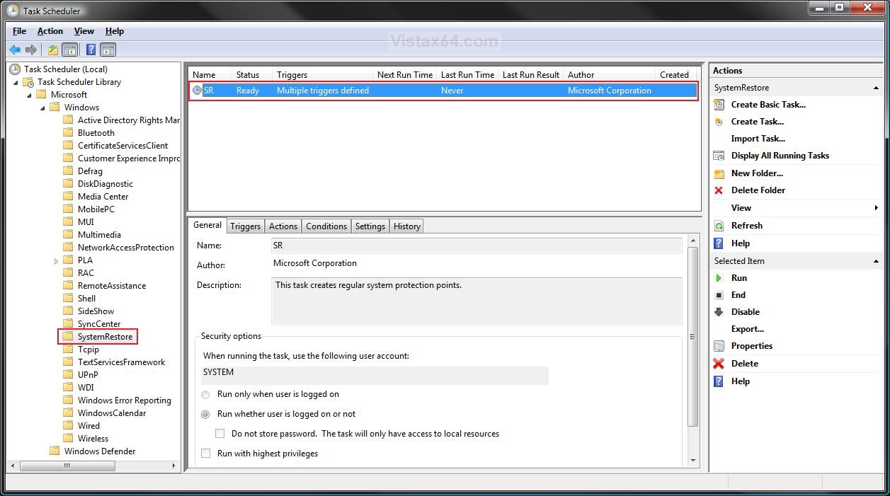

4. In the left pane click on the triangle next to Task Scheduler Library, Microsoft, and Windows to expand the folder tree. (See screenshot below step 5)​
5. Click on the SystemRestore folder.​
A) Choose a option or options below to do.​
OPTION ONE
To Disable or Enable this Task Completely
6. To Disable this Task Completely -
NOTE: This will disable both the Daily (OPTION TWO) and At startup (OPTION THREE) triggers regardless of how they are set individually. You will not have anymore automatic restore points created with this task disabled. You can still manually create a restore point though. For how, see: How to Create a System Restore Point in Vista
A) In the middle pane, right click on the SR task and click on Disable. (See screenshot below step 5)​
B) Go to step 22.​
7. To Enable this Task Completely -
NOTE: Check to make sure that each Daily (step 12 in OPTION TWO) and At startup (step 17 in OPTION THREE) trigger is also set as Enabled.​
A) In the middle pane, right click on the SR task and click on Enable. (See screenshot below step 5)​
B) Continue to OPTION TWO.​

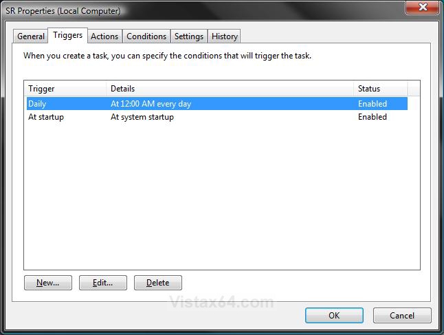

8. In the middle pane, right click on the SR task and click on Properties. (See screenshot below step 5)​

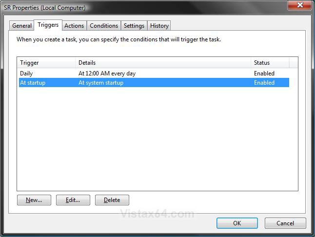

9. Click on the Triggers tab. (See screenshot below step 10)​
10. Click on the Daily trigger to highlight it and click on the Edit button.​
NOTE: These are the default settings for the Daily trigger in the screenshot below.​
11. To Disable the Daily Trigger -
NOTE: This is if you only wanted to have restore points create with the At startup (OPTION THREE) trigger instead.​
A) Uncheck the Enabled box and click on OK. (See screenshot below step 12)​
B) Continue to OPTION THREE.​

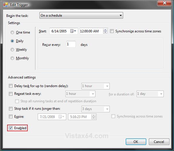

12. To Enable the Daily Trigger -
A) Check the Enabled box. (See screenshot below)​
B) If the default settings for the Daily trigger schedule are not what you want, then make any changes that you would like.​
NOTE: For more details about each of these settings, see STEP FIVE here: How to Create a Task in Vista Task Scheduler
C) Click on OK.​
D) Continue to OPTION THREE.​

13. In the middle pane, right click on the SR task and click on Properties. (See screenshot below step 5)​
14. Click on the Triggers tab. (See screenshot below step 15)​
15. Click on the At startup trigger to highlight it and click on the Edit button.​
NOTE: These are the default settings for the At startup trigger in the screenshot below.​
16. To Disable the At startup Trigger -
NOTE: This is if you only wanted to have restore points create with the Daily (OPTION TWO) trigger instead.​
A) Uncheck the Enabled box and click on OK. (See screenshot below step 17)​

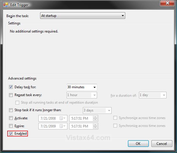

17. To Enable the At startup Trigger -
B) To Speed Up Startup Time - Make sure that under Advanced Settings, the Delay task for box is checked and you have an amount of minutes set that you want for System Restore to run after startup.​
C) If the default advanced settings for the At startup trigger schedule are not what you want, then make any changes that you would like.​
D) Click on OK.​
E) Continue to OPTION FOUR.​

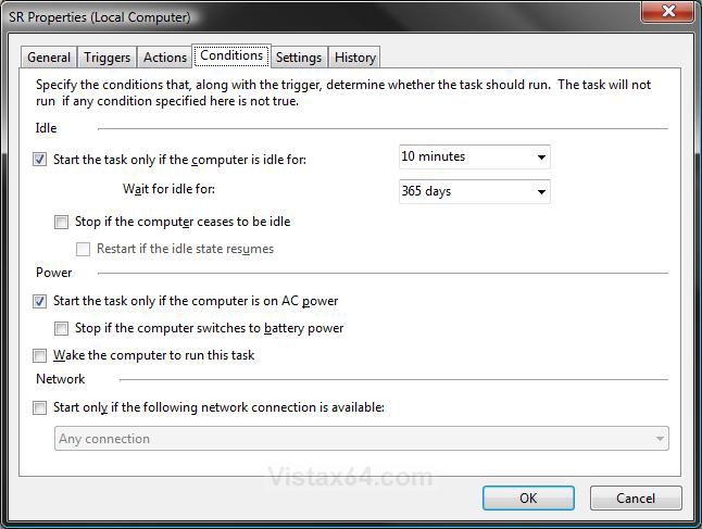

To Change the Conditions for the Task
NOTE: You will need to have the task enabled in step 7 first. This will effect how both the Daily (OPTION TWO) and At startup (OPTION THREE) triggers run. If you do not want to change these settings, then continue to OPTION FIVE.​
18. In the middle pane, right click on the SR task and click on Properties. (See screenshot below step 5)​
A) Click on the Conditions tab. (See screenshot below)​
NOTE: These are the default settings for the Conditions tab in the screenshot below.​
B) Make any changes you would like.​
NOTE: For more details about each of these settings, see STEP SEVEN here: How to Create a Task in Vista Task Scheduler
C) Continue to OPTION FIVE.​

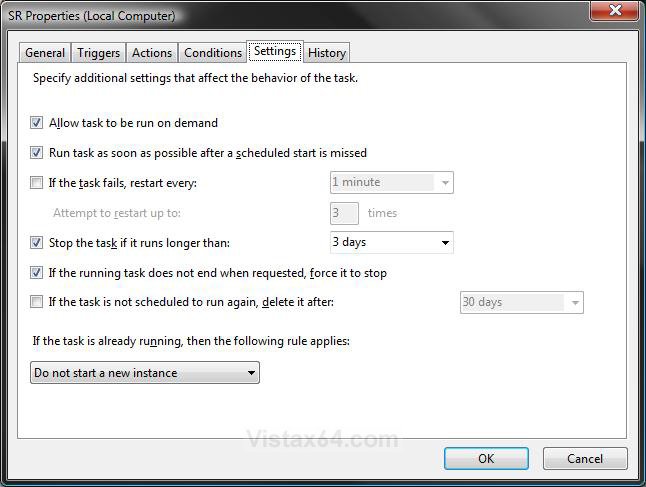

OPTION FIVE

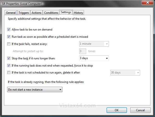

To Change the Settings for the Task
NOTE: You will need to have the task enabled in step 7 first. This will effect how both the Daily (OPTION TWO) and At startup (OPTION THREE) triggers run. If you do not want to change these settings, then continue to OPTION SIX.​
19. In the middle pane, right click on the SR task and click on Properties. (See screenshot below step 5)​
A) Click on the Settings tab. (See screenshot below)​
NOTE: These are the default settings for the Settings tab in the screenshot below.​
NOTE: For more details about each of these settings, see STEP EIGHT here: How to Create a Task in Vista Task Scheduler
C) Continue to OPTION SIX.​

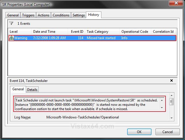

To See the Task History
NOTE: This will show you what the run and error history for this task is. This can be handy to help troubleshoot any problems with the task, or you just want to see when it ran. If you do not want to see the history, then go to step 21.​
20. In the middle pane, right click on the SR task and click Properties. (See screenshot below step 5)​
NOTE: You can also just click on the History tab in the bottom half of the middle pane instead.​
A) Click on the History tab. (See screenshot below)​
NOTE: In the bottom pane you can get more details about a selected history event listed in the top pane.​
B) Go to step 21.​
21. Click on OK. (See screenshots from below either steps 10, 15, 18B, or 19B)​

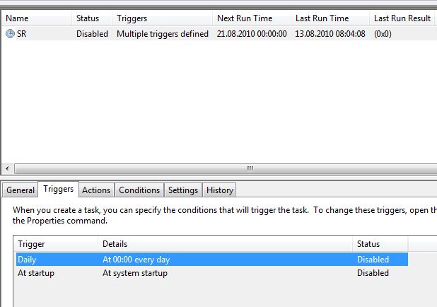

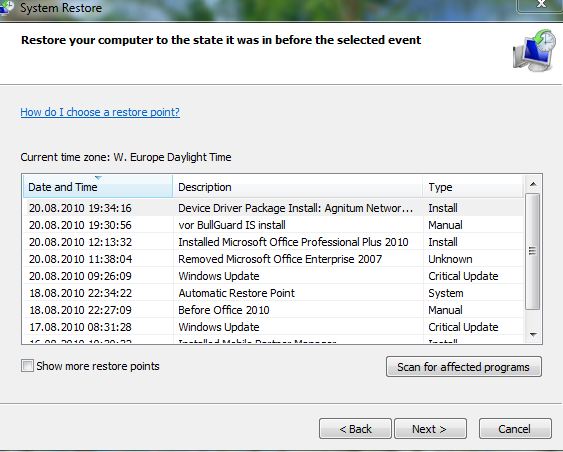

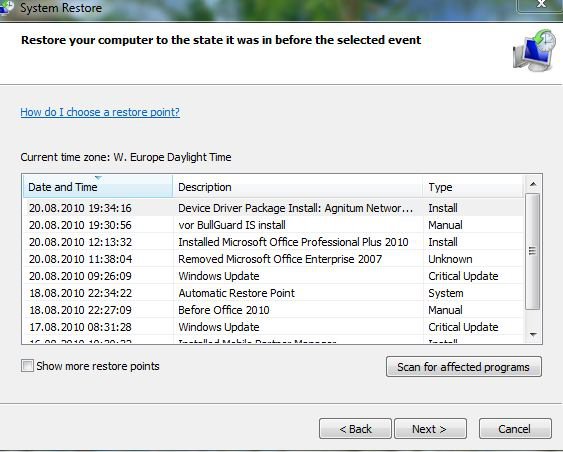

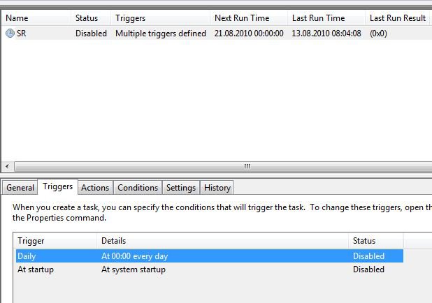

Hi guys - funny thing - my system (win 7 x64) is creating system restore points although the task schedule is completely disabled (see picture).
It's being created when new driver or windows update was installed.
Anyone?
Hello Fire, and welcome to Vista Forums.
Did you also turn off System Restore through system protection properties? If not, it will still create system restore points. ;)
    Logitech MX Master 4
Thanks Shawn - but when I disable system restore then I'll also lose all created restore points, right? I want to keep some "clean" restore points which I created manually.
You're welcome Fire. I hope that it will work for you. :)

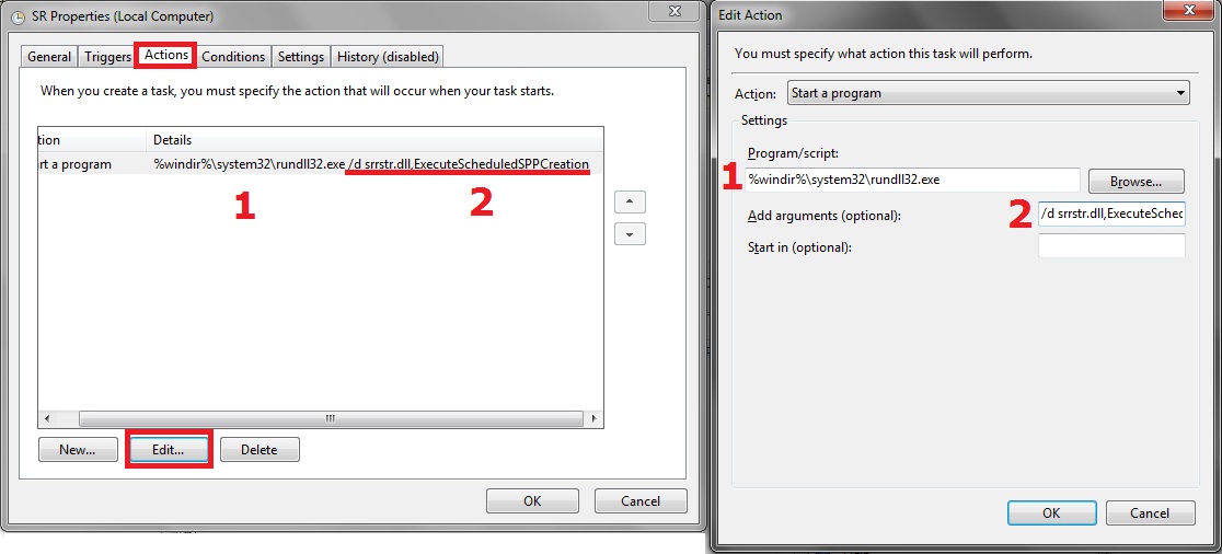

Easy to follow and very informative-but, what happened to the actions tab? You skipped that part, and my problem is that mine is blank. Somehow the program/script and optional argument boxes got wiped and I have no idea what is supposed to be typed in there. It's not hidden either cause I tried running SR and no go. I don't know why they went blank, but with no command in the box SR won't run. If you see this please reply. thanks--gtwyuser
    Gateway MT6705
    intel dual core
    4 gig kingston DDR2x5300
    nvidea
    asus
    1080x840??
    seagate-400gig,7200rpm
    microsoft usb external
    2.4ghz wireless
    standard laptop
    highspeed
    This notebook came with 1gig of ram, and 100gighdd. Specs said 2gigs ram max-I don't like specs. Found the HD at an electronics recycling center--he gave it to me!!
Hello Gtwyuser, and welcome to Vista Forums.
I didn't forget the Actions tab. There's nothing in it that can be set to change the restore point schedule, so there wasn't any point in having it included. That's all.
Here's a screenshot of the Actions tab to help you get your's restored.
