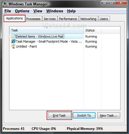

OPTION ONE
To Close a Application
NOTE: This will force a open application you select to close. The application will also be listed under the Processes tab in OPTION TWO below with the application's EXE file.​
1. Do STEP ONE above.​
2. Click on the Applications tab. (See screenshot below)​
3. Click on the application you want to close to highlight it.​
4. Click on End Task.​
NOTE: This will close the application without a confirmation.​
5. Close Task Manager when done.​

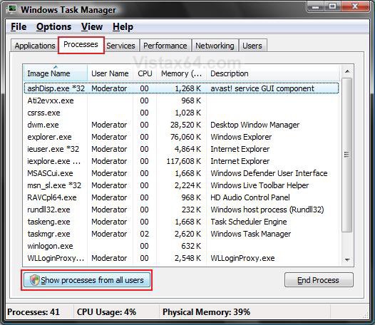

OPTION TWO
To Close a Application or Process
NOTE: This will force a application or process you select, that is open or running in the background, to close.​
2. Click on the Processes tab. (See screenshot below)​
3. Click on the Show processes from all users button.​

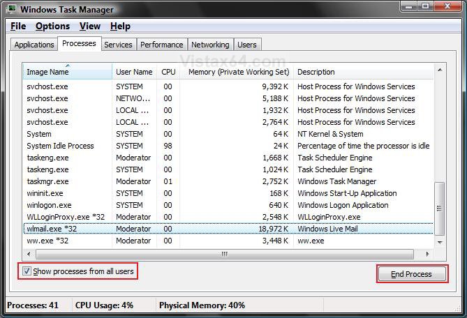

5. Click on the process you want to close to highlight it. (See screenshot below)​
NOTE: The file name will be under the Image Name column, and the application or process name under the Description column.​

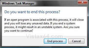

6. Click on the End Process button.​
7. Click on End Process to confirm and close the selected application or process. (See screenshot below)​
8. Close Task Manager when done.​

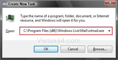

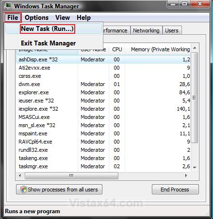

OPTION THREE
To Open a Application or Process
NOTE: This will let you open a program, folder, document, or Internet resource. This is the same as the Run command window.​
2. Click on File on the menu bar. (See screenshot below)​
3. Click on New Task.​
4. Type in the full path of the application or task you want to open and click on OK. (See screenshot below)​
NOTE: You can also click on the Browse button to navigate to the application or task and select it, then click Open. The task may also be listed under the drop down arrrow to select from.​
