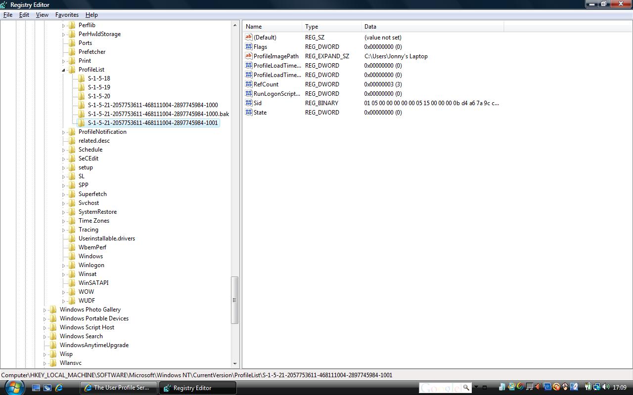

I have failed to log on using my main profile "Jonathan". I have an admin account also.
I followed the steps to try and fix the problem on here.
I've stumbled upon a problem though. It asks if you have two SID folders with the exact same key. I don't have two but virtually three albeit the last one has a one at the end. The one with the 1 is my profile and the one I want to fix but the folder with bak at the end is the admin folder and the one above that a "temp profile" folder. I did a system restore to attempt to fix the problem. Is that why it's doing that? Screenie :
attachment.php
Which instructions do I follow? Step 6 or step 7?
Hello Jonzo0b1, and welcome to Vista Forums.
You attached image is broken. Could you upload and attach it to that post again please?
Thanks for the fast response. One sec, it appears for me. Work now? I'm not great at uploading screenies to forums.
8455d1228756299-user-profile-service-failed-logon-user-profile-cannot-loaded-problem.jpg
I'm still having problems. Is anyone on to help?
S-1-5-21-2057753611-468111004-2897745984-1000 seems to have profileimagepath of temp user
S-1-5-21-2057753611-468111004-2897745984-1000.bak seems to have profile imagepath of admin
S-1-5-21-2057753611-468111004-2897745984-1001 is the one I want - Jonny's laptop and the one not logging on.
Jonzo0b1,
You will need to use step 6 on the two S-1-5-21-2057753611-468111004-2897745984-1000 SID keys. Afterwards, you may be able to log on to the other one as well.
