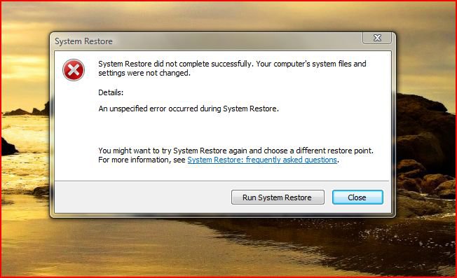

Hi Folks,I am unable to do system restore, After trying i get message stateing, unable to restore try different restore point, which i have tried with the same results, However i am able to restore in safe mode, I dont know if they are connected, but when i go into task scheduler a popup box states, the task image is corrupt or has been tampered with, I have tried deleting user feed, then typing in cmd msfeedssync enable, but does not help, I do have vista repair disc's would that be my best bet at this point, any help would be appreciated, Thanks.patch41. HP vista premium 32-bit

Hi Rich, yes i have tried sfc /scannow and it comes up clean,no errors, i also tried from another user acount, set my own restore point, it accepted my restore point, I downloaded a program, Then tried system restore, the same popup box came up (see atachment) any other suggestions, thanks for help.patch41

Hi rich, tried with norton anti-virus and firewall turned off, same results

Works in Safe Mode, but not Clean Boot, its a program that is causing the problem. Safe Mode turns off everything, but the very essential.
If it were me, I wouild turn off the SR to reset it. That procedure has worked in about 75% of the cases that I have had, like this. If you lose your points, you are not losing much at this point. If nothing works you will be doing a repair install, anyway.
I think that it might be a space problem. Make sure there is a enough free space on the Back up Drive.
http://www.sevenforums.com/tutorials/335-system-protection-change-disk-space-usage.html

Hi Rich, Good news, I got system restore to work, I subscribe to smartcomputing magazine and presented the problem to them,they got back to me, Norton was the problem, i think somebody at vista forums suggested norton was the problem, In the past i just switched of norton anti-virus and norton firewall but i had to go deeper and specifically turn off tamper protection, and when i did that, it worked, I thank you for your help and suggestions, tried to tip the scales but they told me to spread it around,patch41
