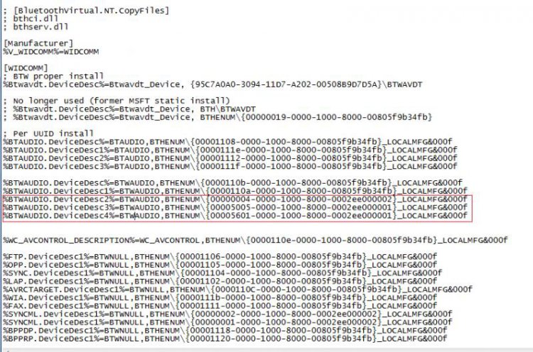

If communications betwwen cell phone and computer fully work this is only small installer issue.Make sure you have the newest drivers HP Compaq 6715b Notebook PC -  Support Software for HP Integrated Module with Bluetooth Wireless Technology (Microsoft Windows Vista) - HP Business Support Center
If yes and still the you have the same problem you have to modify installer this means you have to modify *.inf file in installer add Hardware ID of orphans and again install
Reading Hardware ID
Open device menager
right click on empty devices>>properties>>details>>find Hardware ID
read it and post here.
EXAMPLE
Suppose these missing devices have following hardware ID
BTHENUM\{00000004-0000-1000-8000-0002ee000002}_LOCALMFG&000f
BTHENUM\{00005005-0000-1000-8000-0002ee000001}_LOCALMFG&000f
BTHENUM\{00005601-0000-1000-8000-0002ee000001}_LOCALMFG&000f
1.Unpack InstallShield installer (just double click on it),choose location for unpacked files.
2.Navigate to Win32 folder (if anybody have x64 system then have to choose Win64 of course) and find btwavdt.inf,open it
find [WIDCOM] section,next find BTWAUDIO subsection
and add line in following rule
%BTWAUDIO.DeviceDesc<number>%=BTWAUDIO,<hardware ID>
Above examples in hacked btwavdt.inf looks below:
Save hacked file.
3.Uninstall drivers for bluetooth and install the hacked one.
Good luck ;)

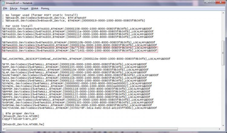

are you still there? I hope so. Sorry, I have been very slow, I hope you are still available. These are the hardware ID's reported with missing drivers of the 2 Bluetooth Peripheral Devices I have found:
Bluetooth Peripheral Device (I):
BTHENUM\{8e771301-0000-1000-8000-00805f9b34fb}_VID&00010000_PID&c0efBTHENUM\{8e771301-0000-1000-8000-00805f9b34fb}_LOCALMFG&000f
Bluetooth Peripheral Device (II):
BTHENUM\{8e771401-0000-1000-8000-00805f9b34fb}_VID&00010000_PID&c0efBTHENUM\{8e771401-0000-1000-8000-00805f9b34fb}_LOCALMFG&000f
As a layman, I would really appreciate if you could give me your comments and recommendations in order to fix this strange problem.
So far, I look forward to your reply.

Flavius,
You have to add only signed red color.Probably your btwavdt.inf will be looks like as here:
EDIT
If you have any problems show screen from your btwavdt.inf file
