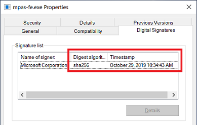

Hi, is it possible that Vista don't want to install latest definitions on windows defender because of this?
Taken from the website: Latest security intelligence updates for Windows Defender Antivirus and other Microsoft antimalware - Microsoft Security Intelligence
Note: Starting on Monday October 21, 2019, the Security intelligence update packages will be SHA2 signed.
Please make sure you have the necessary update installed to support SHA2 signing, see 2019 SHA-2 Code Signing Support requirement for Windows and WSUS.
Hi bzbox:
This could be an issue going forward from 21-Oct-2019 for any Microsoft products installed on Vista SP2 machines that should still be receiving regular updates. The properties for the Windows Defender standalone mpas-fe.exe installer I downloaded today on 29-Oct-2019 (Definition v1.305.927.0) is signed exclusively with a SHA-2 hash:

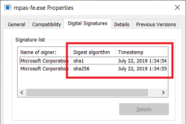

However, I don't think that explains why Windows Update was not detecting these Windows Defender updates as far back as July 2019. I still have copy of the old mpas-fe.exe installer I manually installed on 22-Jul-2019 (Definiton v1.299.282.0) and it was still dual-signed with both SHA-1 and SHA-2 hashes.
I wondered the same thing myself and asked about these digital signing requirements back in July 2019 in the Jody Thorton's MSFN thread Server 2008 Updates on Windows Vista. The response from VistaLover (who I believe had already installed the required April/May 2019 Win Server 2008 security updates to support SHA-2 signing) also noticed that Windows Update stopped delivering updates for Windows Defender definitions on their machine around 06-Jul-2019 and didn't think the problem had anything to do with SHA-1 vs SHA-2 signing (at least back in July 2019).
Not just possible: I am quite certain it would prevent you from installing the latest definitions for Windows Defender.

bzbox
That's why I am asking, downloading mpas-fe.exe manually, then runing as administrator worked until 21.10.2019.
Is there any chance this will be corrected or is now really over with Defender updates for Vista?
