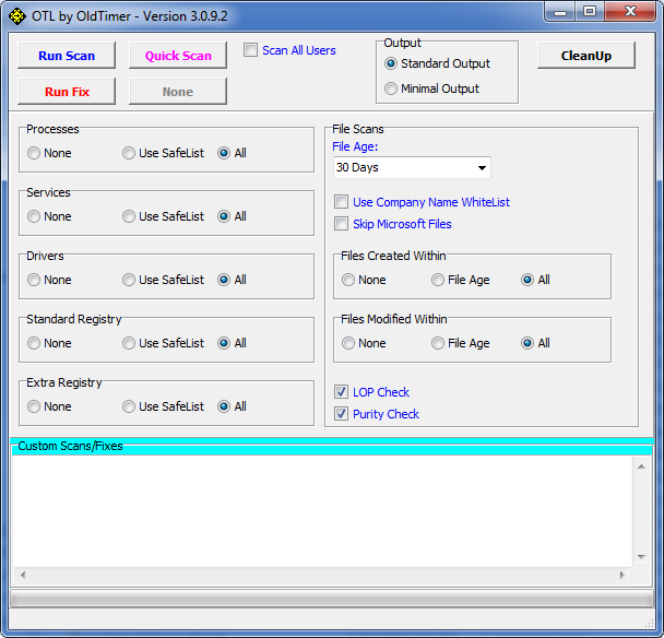

Ok, here's the OLT tool report..
  • OTL.zip

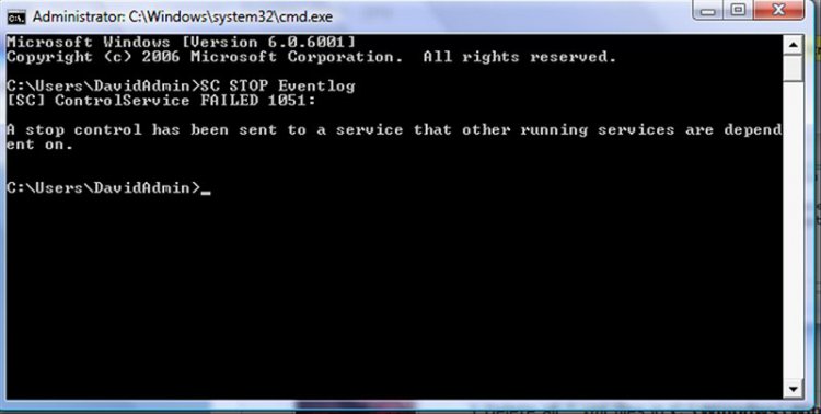

just to clarify why I went to safe mode.. in normal mode the command was refused.
see attached screenshots from normal mode.
As you will see, I did run it as admin (and logged in as admin) - and by the way I have UAC turned off.

This command work on this service only it stop also services which depence from Event Log -here Task Scheduler- yes I should estimate it -neverless after restart Task Scheduler should work again.Make sure Task Schedule service is working after restart.If not - import attached fix to registry +restart because you can't change setting for Task Scheduler in services.msc.Next attache log from VistaInfoTool
