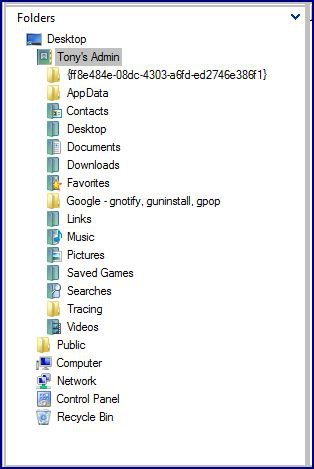

This tutorial will show you how to restore a personal user folder if it has been deleted, in the wrong location, or is missing from your C:\Users\(user name) or Start menu location.
If you have duplicate user folders instead, then you will need to backup the contents of the duplicate user folders, do OPTION TWO below, delete the duplicate folders, then you may need to restart the computer a couple of times first before the default location is restored.
EXAMPLE: Personal User Profile Folders
EXAMPLE: Personal User Profile Folders Start menu Location
OPTION ONE
Restore User Folders Using Folder Properties
NOTE: This can help restore the default location of a user folder. If it does not help, then use OPTION TWO below.
1. Right click on the user folder that you want to restore the default location for and click on Properties.​
NOTE: Do this from the C:\Users\(user name) location for the best results and not from the Start menu user folders.​
2. Click on the Location tab. (See screenshot below step 3)​
NOTE: If you do not have a Location tab, then this is not the correct user folder and is only a normal folder that has the same name as the user folder. You will most likely need to use OPTION TWO below in this case instead.​
3. Click on the Restore Default button and click on OK. (See screenshot below)​
4. If you get this, then click on Yes. (See screenshot below)​
5. Click on Yes. (See screenshot below)​
WARNING: If you do not click on Yes, you will have two copies of the personal user folder in the main (user name) folder with one being as described in the NOTE under step 2.​

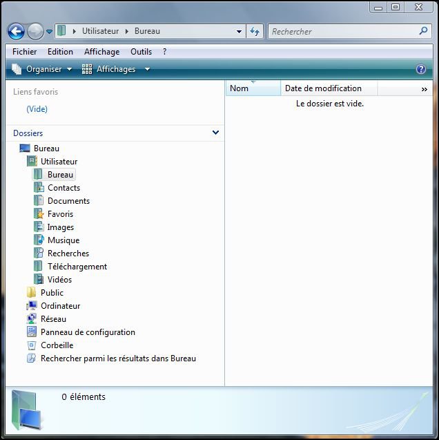

Hello Neil, and welcome to Vista Forums.
If the icon for it is set to small, then this is normal. The Navigation Pane uses small icons as well and cannot be changed. The icon view will need to be set to medium or larger to have the arrow included in it.
Hi Shawn! Thank you for your welcome and your prompt reply. I've tried re-setting the icon size but, as you say, the folder icons in the navigation pane are normally small. What seems abnormal is that for some of my folder icons (Musique, Images Favoris etc - by the way, this is a French version of Vista; I live in France) the larger icon above the status bar looks the same as its smaller counterpart in the Explorer tree but for the Desktop (Bureau) and Downloads (Téléchargement) folders - the two folders I've just replaced - they are not. I've attached a screenshot which should show you what I mean.
    Dell Latitude D820
    Intel T2500 @ 2.00 GHz
    2.00 Go
Neil,
This is normal. Since the icon is larger in the bottom "Details Pane" it will display it. When those folders have a small icon, then it will not display. :)
Hi Shawn! You're right! I think what was bugging me about Explorer was that I'd also deleted the Links folder which meant I had no default Favourite Links in the Navigation pane. I've now restored the Links folder using the shell:Links command and all is well. Many thanks for your help. This is an excellent forum; I've learnt more here today than I have in a week anywhere else.
    Dell Latitude D820
    2.00 Go
You're welcome Neil. You may be happy to know that in Windows 7 those small user fiolder overlays display for all the user folders with small icons now. :)

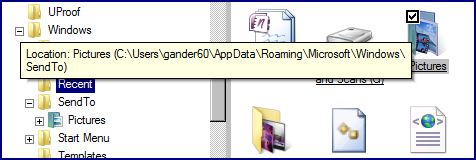

hi there, the tutorial works a treat, but i have a related problem that keeps happening over and over again when i add new music to the folder, for example, i have a backup CD of the MyMusic file from an old computer and sometimes i put songs from there onto my current computer and the folder icon goes yellow 'boring' icon, also happens occaisionaly when ripping a cd into the mymusic folder, and also when moving music from one location to another on my computer (for example the C: Downloads folder to Music - not illegally may i add:)) or evn moving a loose song into a folder within Music. is there any way that i can make sure that the icons wont change next time i add music to this folder or move music around within it? it's really beggining to annoy me.
i used your shell folder tutorial to restore them but to have to keep on doing it is a chore!
Cheers, Sk8ingperson (Ian)
Hello Sk8inperson, and welcome to Vista Forums.
If this is not the same tutorial below that you meant, then you might see if it can restore the default user folder icon for it instead. If you are also copying a dektop.ini file into the C:\Users\(user-name)\Music folder, then that may be the cause.
http://www.vistax64.com/tutorials/90705-personal-user-shell-folders.html
that was the tutorial i used to get the icon back to the default, but i dont understand why when i move music within the folder, or move music from somewhere else into the file it always turns the music folder yellow again. im not aware the desktop.ini file would be in a ripped music file, and copying and pasting a folder from one location to another should just move the mp3 files. im not explaining this very well, but i don't know how to word it so sorry if im being a pain:)
Not at all.
Before you copy over the files into your C:\Users\(user-name)\Music folder, check to make sure that it does not have a hidden desktop.ini file in it. If it does, then delete it first. You would not want to move the C:\Users\(user-name)\Music folder around though. Doing so will cause this as well.
Personal User Folders - How do I clean up the mess?
As can be seen by the following 'snips', it is quite apparent that my User Folders are in a state of confused disorganisation, with some 'yellow' Folders and an unknown File string, obviously in places where they shouldn't be. I haven't a clue how I've managed to create this chaotic mess, a 'senior' moment perhaps!
What concerns me, is the rather large duplicated Pictures Folder that can be found at - C:\Users\Username\AppData\Roaming\Microsoft\Windows\Recent\SendTo.. here;
Is this the 'usual' Folders setup?
I would like to know how to restore my Folders to some sort of 'normal', organised setup, and by what method I should apprioach it. Is there an Elevated Command that can be run to restore the Folders to a 'default' Windows layout?
    nVidia GeForce Go 7300, 128MB
    1280x800x60Hertz [max.]
Hi Tony,
Other than the folder with the long numbers in the top image, I see nothing wrong. It looks like you have your hidden system files (yellow folders) set to show. It looks like you or a program may have added the Google folder as well.
The recent items is just what you have opened recently. I did notice that the folder is named Recent instead of Recent Items with a icon instead of a yellow folder. You can do what is in the red warning box in the tutorial below to fix this.
http://www.vistax64.com/tutorials/72816-recent-items-list.html
