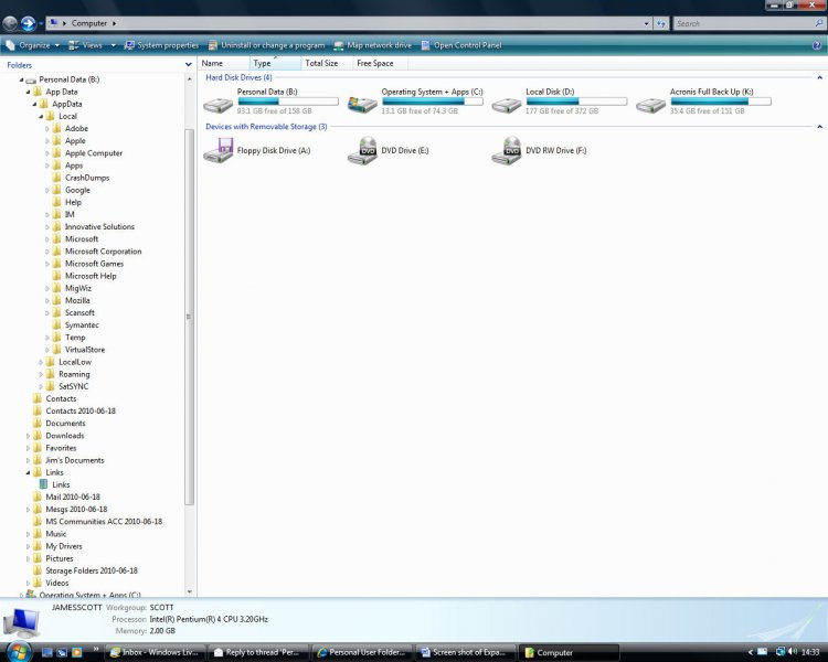

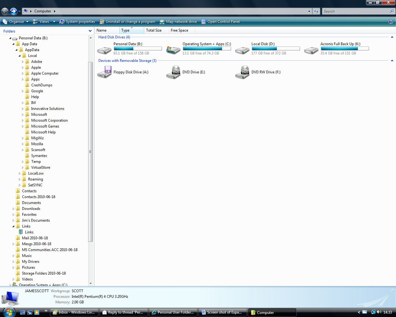

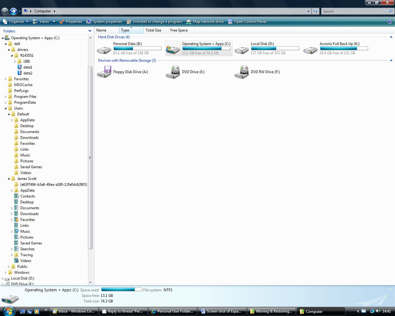

Hi Sorry this may be in the wrong part of the forum but it would see that half of my problem is answered by 'Brink' in his advice on reinstalling personal folders. Is there a similar way I can reinstall the folders for my OS and other Apps? Please
I have just completed a clean reinstall of Vista Home Premium (Upgrade). I backed everything up to an external HD.
I decided to split my 'C' drive into two partitions: 'C' with my OS and all my Apps and newly named 'B' partition to contain all my personal data.
I have been reinstalling my various folders/files to both my 'C' partition/OS volume and my 'B' partition/Personal folders/files. However, I have made a complete mess of the various standard files/folders in both partions. I am now in the position I have no idea what the names of the files/folders I require in the 'C' OS partition and the Names of the ones I require in my Personal partition 'B'.
Please would someone provide a list with names of folders and sub folders in their hierachy for each partition and how to reinstall them for each area?
I believe I can decide on folder/file names in the 'B' partition but are there some that need to exist in that area in order to enable the Vista system to function. Clearly there is a need in the 'C' partition.
Any help please?
Jimlad
Hello Jimlad, and welcome to Vista Forums.
I'm not sure on exactly where you put what, but it really depends on what you meant by personal data (ex: user folders ??) and how you moved it on the B partition. I think it may be better if you post a screenshot of each of your partitions hierarchy to see if we may be able to spot something out of place.
Re: Personal User Folders - Restore Missing Folders
Thanks for picking this mess up for me.
My problem is I’m not sure where I put what either – sorry.
Not sure what you mean by ex users? I am the sole user on this system.
Let me explain what I was trying to achieve. As I had had problems with needing to carry out clean reinstalls, either due to system problems or introducing a new OS, I wanted to have a setup that enabled me to have all my personal data on a separate partition (‘B’), thereby saving me the need to risk loss of data – Personal files, Email, Favourites, Drivers, Contacts etc etc.
For my Operating System (Vista Home Premium 32b) and any Applications I add to my system, I put them on my resized partition (‘C’).
I did an Acronis TI 2009, backup of my old partition ‘C’ which contained both my OS other Applications and all my personal folders and files i.e. my total system on my old ‘C’ drive or partition.
I also did exports/backups of my Emails in total, my drivers, contacts, favourites and all my personal folders and files held in the top folder Jim’s Documents.
I then created my new partition using free software Easeus Partition. I did a clean reinstall of my Vista Home Premium Upgrade DVD, added my other Applications to my new partition ‘C’, reinstalled my drivers, I then set about copying and pasting or drag and dropping my favourites etc etc to my new ‘B’ partition. As I wasn’t too sure what data I could put on the ‘B’ partition and I didn’t, and still don’t know how the interaction takes place between the two partitions I started moving folders back, deleting some and really screwed up. Having read your tutorial about moving Personal folders I can see it is wrong what I did.
What I need to know is what folders are a must have and in which partition they reside and how to get my ‘B’ and ‘C’ partitions to talk to each other, if that makes sense.
Hoping it’s not another clean reinstall!
Currently if I choose to save a document to my personal folders, the system selects mt 'C' partition and not my 'B' partition. I have to correct this each time??
Please see attachments requested of my expanded files and folders on partitions 'B' and 'C'. hope they are readable.

Jimlad,
Sorry, but I'm not able to view DOC files currently. A JPEG would be better.
With a clean install you will have to reinstall all programs and drives, these cannot be copied back over from a backup. The only thing that you can copy over is the contents from inside your user folders from the backup to the inside of your current installation's user folders. Afterwards, you can move the user folders in your current installation to your B: drive as you did before like in this tutorial.
Hope this helps for now.
Hi again Brink,
Here are the screen shots in Jpeg. Hope they are readable? Let me know if you require any further local expansion to ensure I haven't got some folder which should be at a higher level wrongly placed at the lower level, causing problems?
Sorry but I am not understanding fully what you are saying quote "The only thing that you can copy over is the contents from inside your user folders from the backup to the inside of your current installation's user folders. Afterwards, you can move the user folders in your current installation to your B: drive as you did before like in this tutorial."
Are user folders what I am calling my personal folders?
When you talk of copying the contents...... are these sub folders self generated by me, but held in a system mandatory folder set up as part of the OS?
When you talk of moving folders, you are not saying copy and paste or drag and drop, as I had done. But as per the Tutorial. Sorry just making sure I fully understand.
You didn't have any comment on this question I was posing "What I need to know is what folders are a must have and in which partition they reside and how to get my ‘B’ and ‘C’ partitions to talk to each other, if that makes sense." If it is a stupid question I would like to know it is. If not I want to know if the high end privided folders have some link/trigger to the OS?
Jimlad

Jimlad,
Sorry, yes "user folders" is the same as "personal folders". These would be all of the Music, Pictures, Documents, etc.... type folders in your C:\Users\(user-name) folder.
You would just need to "Copy and Paste" or "Drag and Drop" the contents in the backed up user folders to inside the new ones created in your new clean installation so the data will be in them. Afterwards, use the tutorial to move the user folders in your clean installation to your B: drive.
