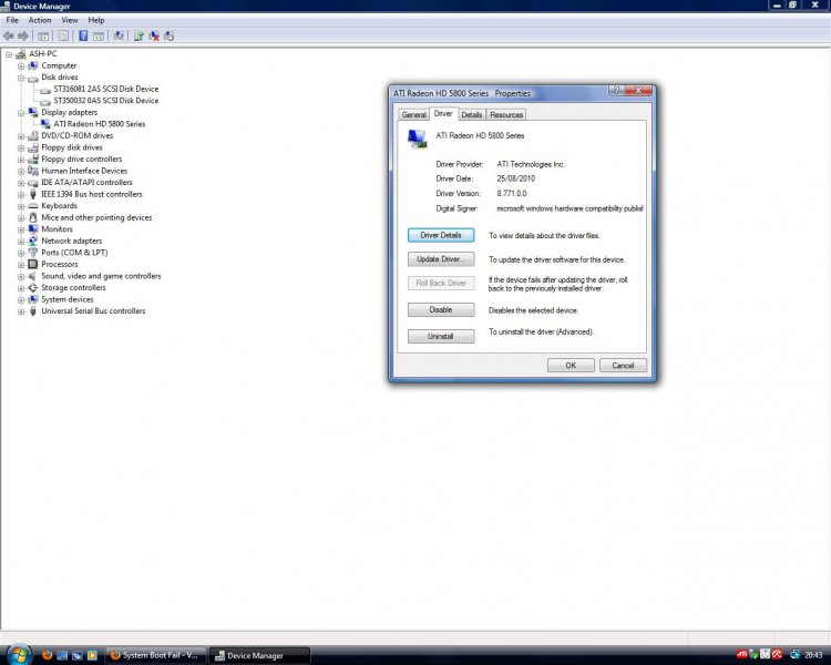

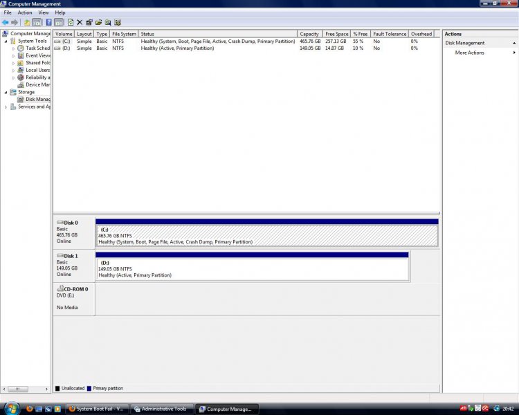

Also, I'd like you to go to Start / Control Panel / Computer Management / Disk Management. Make sure it is full screen and take a screenshot and save it as a .jpg file and attach it to your next reply along with the above files.
Then go to Start / Control Panel / Device Manager and expand the entries for the disk drives and the video drivers and take another screenshot, save it as a .jpg file, and attach it to your next reply.

First and foremost, Thank you for all the replys and trying to help me get to the bottom of this problem!
I'm not sure if the second image is quite what you wanted but i think it is. Also yes the graphics card and motherboard are correct, Thanks again.

From what I can see, all the drives seem to be fine and recognized. In fact, your hard drives are C: and D: and the CD drive is E: as it should be - and not with the CD drive between the two hard drives as I had thought. There's nothing in those screens to identify a problem (other than drive D is getting a little full, but nowhere near the point of causing this problem - especially since it isn't the boot drive).
