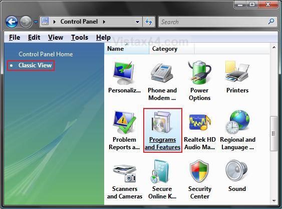

1. Open the Start Menu.​
2. Click on the Control Panel button.​
3. In Classic view, click on the Programs and Features icon. (See screenshot below)​

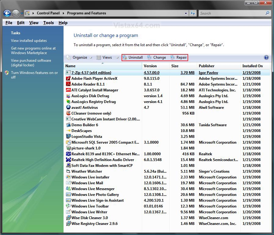

4. Highlight a listed program to see the available option on the toolbar for it. (See screenshot below)​
NOTE: The options will be either Uninstall, Change, Repair, or a combination of these. A program may not have all the options available for it.
A) If mouse is set to single click, then hover the pointer over the listed program.​
B) If mouse is set to double click, then left click once on the listed program.​
5. Click the option you want to do on the toolbar, or right click on the listed program to select the option. (See screenshot above)​
NOTE: See an explanation of each option, if available for the program, in steps 6 to 8 below.​

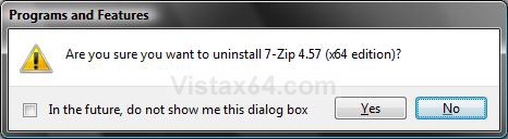

6. To Uninstall a Program
NOTE: Uninstall will run the selected program's uninstall program to uninstall the selected program. If you check the In the future, do not show me this dialog box option in the confirmation prompt, it will disable the confirmation prompt and will not be seen again until restored. See: How to Restore the Uninstall Confirmation Prompt in Vista Programs and Features
A) Click on Uninstall or Uninstall/Change.​
B) Click on Yes. (See sceenshot below)​
7. To Change a Program
NOTE: The Change option is used for software that can be installed in modules and/or have different setups, such as a productivity suite where you can install applications independently. Should you decide to add or remove components at a later time, the Change install comes in handy.​
A) Click on Change.​
B) Make any changes in the installation setup program.​
8. To Repair a Program
NOTE: Repair is usually used when you want corrupted files and settings replaced with original ones from the selected program's installation program. Sometimes the entire program is just reinstalled with all files overwritten and settings returned to default for the selected program.​
A) Click on Repair.​
9. If prompted, click on Continue in the UAC prompt.​
10. Close Programs and Features when done.​
