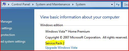

yea i got 256 installed. still unable to get a single update after installing sp2 however. just cant seem to figure this issue out.

Hmmm, sp2 has been around since 2009 and isn't known for breaking Windows Update. One common issue with factory restores is that sp1 doesn't install correctly even though Windows Update shows "Successful." Does System properties actually show sp2, or any service pack at all for that matter?
If you are forced to restore again, there is a Vista ISO download thread in the General Discussion forum that might save you some trouble.
[Edit] If you are still following this, my advice would be to reinstall the most up-to-date image you have because the problem apparently had nothing to do with your installation.

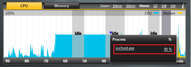

I run Windows Update manually (i.e., WU is set to "Never check for updates") and the problem began for me on 12-Aug-2015 when I tried to download the Aug 2015 Patch Tuesday updates. The issue could be related to the number of updates available for download. After several failed attempts I finally got Windows Update to run to completion on 16-Aug-2015 (see image below) but Windows Update got stuck at "Checking for updates...." for about 40 min (continual high CPU activity from wuauserv service running under svchost.exe as if one core of my CPU was saturated - but no disk thrashing after the first few minutes) before it finally reported that 1 optional and 17 important updates were available for download. The entire update process, including download, install and re-boot, required about one hour.
When I ran Windows Update again on 18-Aug-2015 to check for the out-of-band critical update for IE (KB3087985) it was a still a bit sluggish but "Checking for updates.." only took about 4-5 min.
