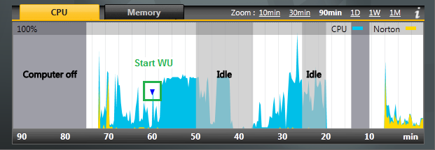

I downloaded and manually installed KB3161664 (MS16-073: Description of the security update for kernel mode drivers: June 14, 2016) last night. This was the only Windows kernel-mode driver (Win32k.sys) update missing on my system from Dalai's list of recommended updates since my Vista OS was fully patched as of May 2016. I started a manual Windows Update this morning about 10 min after booting up and "Checking for updates..." finished in about 20 min (compared to 5 - 6 hours for my previous Apr 2016 and May 2016 Patch Tuesday updates). The entire Windows Update session completed in about 40 min.
Here's what the CPU consumption looked like for my June 2016 Patch Tuesday Windows Update with KB3161664 pre-installed, with:
  • "Checking for updates..." running for 20 min between the 60 and 40 min marks
  • Download and installation of 10 important updates between the 40 and 20 min marks (this month's Malicious Software Removal Tool scan ran for the last 8 mins of the installation phase)
  • Re-boot to finish installation (dark grey band) around the 15 min mark

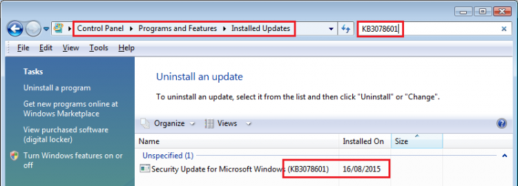

Hi gordon55y:
If you tried to install KB3138615 from the second table then note the column headings - these are KB updates for the Windows Update Agent (wuaueng.dll) and only apply to Win 7 and Win 8 machines. Since you have a 32-bit Vista system you are only interested in the five KB updates for the Windows kernel-mode driver (Win32k.sys) in the first table - the correct download links for 32-bit Vista have the column heading Vista x86.
Dalai's instructions at Search for Windows Updates takes forever? - A possible solution assume a certain level of technical expertise and can be a bit confusing. I posted step-by-step instructions today (16-Jun-2016) in m#l's thread Updates not working, it has been searching for updates for hours in the MS Answers forum that should be easier to follow.
I ended up visually scanning "view update history" for KBs. That is really error prone, can I search for a specific KB?
You might also find it's easier to use the Search function at Control Panel | Programs and Features | View Installed Updates to look for installed Windows updates, which is what I recommend in Step 3 of those instructions.
It sounds like you eventually managed to install this month's Win32K.sys update KB3161664 (MS16-073: Description of the security update for kernel mode drivers: June 14, 2016) before running Windows Update to install your June 2016 Patch Tuesday updates. If you aren't certain that you're fully patched try running another Windows Update and see if it finds further updates.

Imacri,
OK, thanks.
I had tried searching from
I see my error now.
I assumed it worked like a normal search.
It does not.
For instance if I search for the suffix 8601, it will not find KB3078601
If I search for KB307 only, it will find all with that prefix.
And yes, I reran update and got no new updates :-)
I observe that a regular update takes 30 to 60 mins to simply find the updates (not download/install) :-(
Is that normal?
My vista laptop has always been like this.
XP was a minute or so, win7 is a few minutes.
gordon
vista home SP2 32bit
Last evening I ran Windows Update, without first installing June's KB3161664.
May's update search was slow - 8 hours - but my system was a couple months behind.
Subsequent searches were fast, so I ignored the recommendation of manually installing the Win32k.sys update.
Result: my update search completed in a blazing...7+ hours.
Downloading and installing actually proceeded at a normal pace, about 10 minutes.
I think I need to take a different approach for next month.
