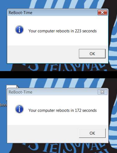

This is the before and after boot up time for my computer after I changed it to use all 4 cores. For fun you can post your results here: ReBoot Time

Well, big improvement! Amazing

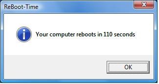

great improvement for me too, went from 241 to 206, very pleased, will carry on tweeking

That's great news. Did this include any other performance tweaks other than what the tutorial is for instead?
nope, the times above was just by selecting to boot up using both processors :D

Very impressive results. :)
no tweaks done except changed number of processors at boot- set 2 processors, little improvement, and that script i think made things slower.

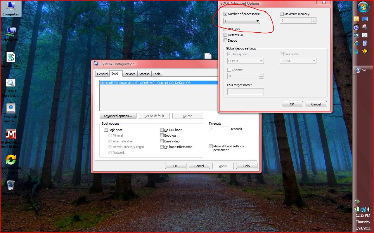

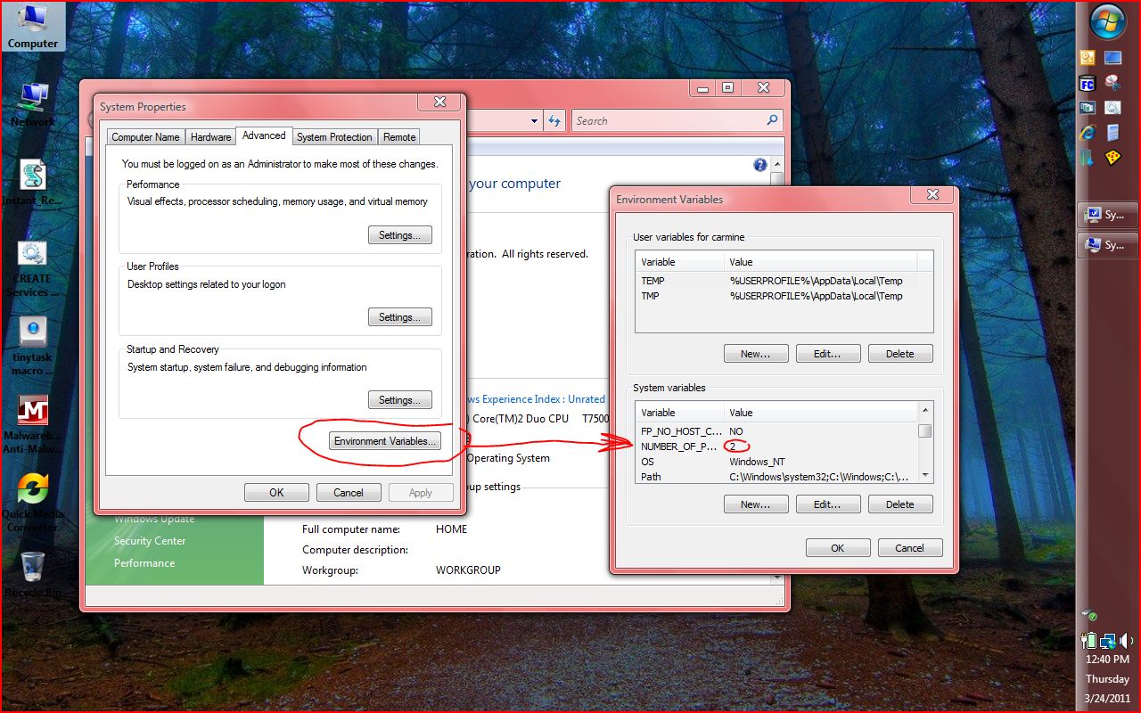

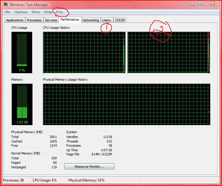

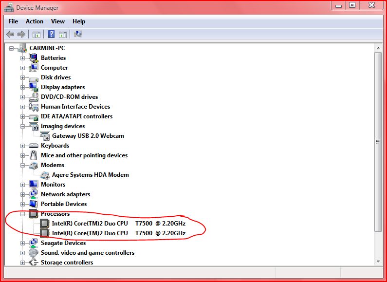

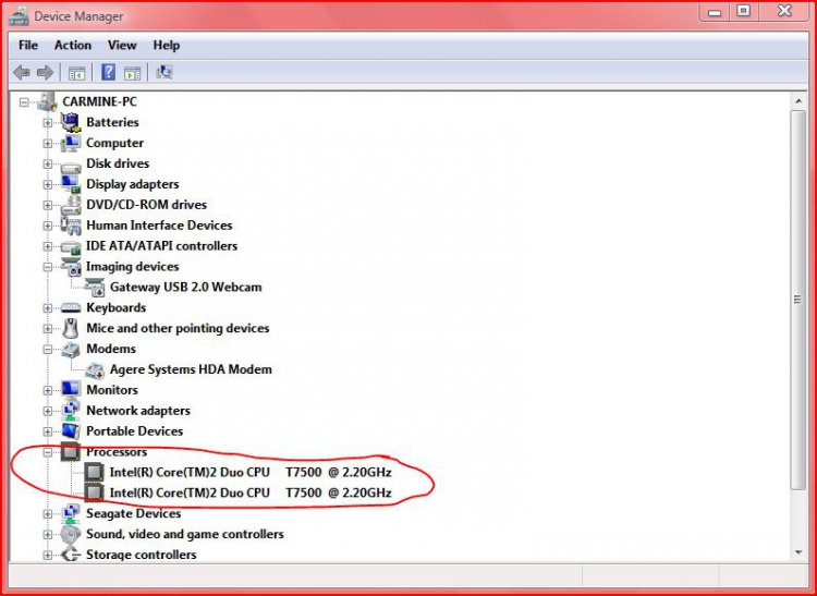

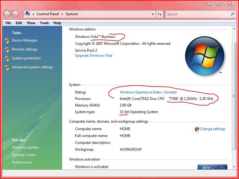

I had a strange issue today. I always knew I had a dual processor, but today, it only showed one. so I googled around, searched the vistax64 & sevenforums and found nothing.
I then remember something about the no. of processors in the enviorment variable section. after changing it back to two a few times and rebooting it took.
strange it was changed to one. I don't know why, but it's cool now.

Hello Carmine,
That is strange. What happens when you uncheck the Number of processors box?
It should allow Vista to use all processors/cores by default if unchecked as well.
When I uncheck the no. of processors and rebooted it did nothing. I had to change the enviorment variable number of processors to two. It all started when I wanted to see how long the system uptime was and it only showed one cpu box.
now it shows the two.

Ok, good. :)
