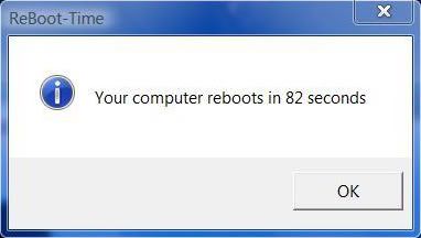

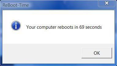

EXAMPLE: Boot Up Time Before and After
NOTE:
This is the before and after boot up time for my computer after I changed it to use all 4 cores. For fun you can post your results here: ReBoot Time

with-out extra cores selected
with all cores; Also this is with Detect HAL on, I also ran with-out HAL and had the same boot time.
