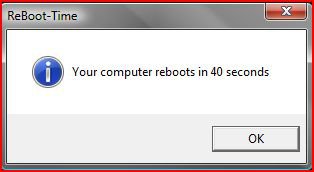

WOW............reboots amazingly fast now

That's great news Micman. Thank you for posting back your results.
