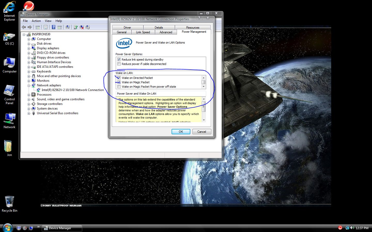

To Disable or Enable the "Allow this device to wake the computer" Option for a Device
  • Check your Network device. Network activity can cause the network hardware to wake the computer, especially when the network is always on (like cable and DSL connections).
  • High Definition Audio, if listed in STEP FIVE, may also rarely cause the computer to wake from sleep mode. You can disable (only option available) the device as a test in Device Manager to see before putting the computer to sleep. Just enable it again if it is not the problem.
2. Click on the Device Manager icon.​
NOTE: You need to be in a Administrator account.
4. Open the device's list that you want to change. (See screenshot below)​
EX: Network Devices
5. Right click on the device name and click on Properties.​
EX: Network Devices
6. Click on the Power Management tab. (See screenshot below)​
7. Uncheck Allow this device to wake the computer. (See screenshot above)​
NOTE: To Enable it again, just check this instead. If you need to disable the wireless mouse and keyboard, then you can wake the computer by pressing the power button on the case.
8. If listed, check Allow the computer to turn off this device to save power. (See screenshot below step 6)​
NOTE: This will turn the device off when the computer goes into sleep mode.
9. Click on the Advanced tab. (See screenshot below)​
NOTE: This is only for the Network device.
10. Check the boxed in red Property: items below to see if they are set to Disabled in the Value: area. (See screenshot above)​
NOTE: This area may be different for your particular network device since it is based on the driver, but it should be similar. You will be looking for any Wake on type property options listed.​
11. Click on OK to apply and close properties window. (See screenshot below step 6 or 9)​

Venom,
The Allow the computer to turn off this device to save power option under the Power Management tab is the one responsible for turning the light on or off for the modem.
Unless you needed to have the modem on and have it wake up your computer, it is usually best to leave this option checked and Allow this device to wake the computer unchecked. :)
I do not have that option under the power management tab, under it I have two boxes, one with Power save options that contains Reduce link speed during standby that is checked and the other is Reduce power if cable disconnected that is unchecked. Then under that I have another box labeled Wake on LAN that has, Wake on Directed packet, Wake on Magic Packet, Wake on Magic Packet from power off state. The only two I messed with were the wake on Direct packet and Magic packet that I unchecked. Then My light goes out.
The problem I keep having is that every now and then when set to away or sleep it pops back out after a few seconds.
Should I care that my PC disconnects from the modem then?
This is what I am doing,

If you do not want your computer to be woken up by your modem, then you will need to uncheck all of the "Wake on..." options.
Your computer will connect right back to the modem as soon as it wakes up next, so it will not hurt anything since your computer is asleep anyway. :)
