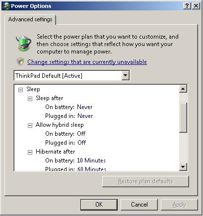

Check Advanced Power Plan Settings
NOTE: Power settings control the computer’s ability to go into and come out of sleep/standby mode.
2. Click on the Power Options icon.​
3. Click on the Change plan settings link under your power plan. (See screenshot below)​
4. Click on Change advanced power settings. (See screenshot below)​
5. Click on Change settings that are currently unavailable. (See screenshots below step 10)​
NOTE: This will allow any Power Options that are grayed out to now work and not be grayed out.​
6. Recommended Settings for Sleep
NOTE: Sleep saves any open documents and programs to memory only, and then puts the computer into a low-power state.
WARNING: If you lose power to the computer, you will also lose what is in memory.​

9. Click on OK to apply​
10. Just exit out the other windows.​
11. Test sleep mode. If it is still not working correctly, then continue to the next step.​

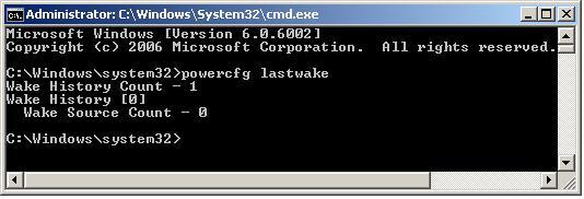

To See what had Waken Up Windows Last
NOTE: This will give you a list of items that woke up the computer last that may help narrow down what is waking up the computer.
1. Open the Start Menu.​
2. In white line (Start Search) area, type cmd and press Enter.​
3. In command prompt, type powercfg lastwake and press Enter. (See screenshot below)​
NOTE: Notice that I had USB\ROOT\HUB listed. For me, this would be the USB wireless mouse. Your list results will vary of course.​

Did you have hybrid mode enabled where your computer will go to sleep first for a bit, then later go to hibernation?
I'm not quite sure to undestand the question : here is some aspects that might help -powercfg -a states that s3 is available on the system, while s1 & s2 are not supported by the firmware. No word on S4 - the start buton does show hybernate a option - i can notice a file stored at the root called hyberfil.sys of 3gb - the disk cleaner show the option to clear the file (as indicated in your tutorial) - in the power plan the hybernate is set after 20min, and the hybrid is to Yes Does that helps ? Regards
    Lenovo T61p, 3Gb RAM, 100Gb HDD
    Centrino pro
    3Go
Yep, that helps. Set Hybrid to "Never" in step 8 of the STEP TWO section for the recommended settings for hibernation. That should allow you computer to save to the hiberfil.sys file and then go into hibernation without using any of the battery.
I'm having the same problem as many people here but I still haven't been able to solve it. I was using Hibernation on my laptop ALL the time, so it was working perfectly before... it's just after I installed Adobe Dreamweaver that I stopped being able to put my computer into hibernation mode.
Everytime I try to hibernate, the screens turns off for a few seconds and after that it just takes me back to the login screen.
I have followed all the steps in the tutorial (except the restoring one because it seems I lost all my restoring points), and I still can't seem to find the solution. I have disabled all the devices that were able to wake my pc up, changed the energy management options, everything.
I also uninstalled Dreamweaver and the problem is still there.
Any suggestions?
What does it show you in STEP FOUR as to what last woke up your system?
Hello again, i've attached two screen shots.
powercfg -lastwake and the way it is set up
The computer goes into hybernation but it is still S3 type of hybernation and takes about 10% of the battery per 24hrs
Your help is much appreciated, best regards
