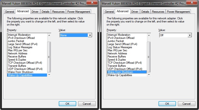

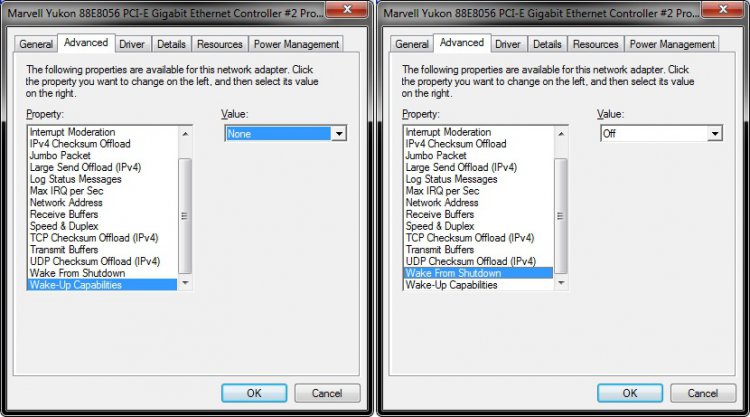

9. Click on the Advanced tab. (See screenshot below)​
NOTE: This is only for the Network device.
10. Check the boxed in red Property: items below to see if they are set to Disabled in the Value: area. (See screenshot above)​
NOTE: This area may be different for your particular network device since it is based on the driver, but it should be similar. You will be looking for any Wake on type property options listed.​
11. Click on OK to apply and close properties window. (See screenshot below step 6 or 9)​

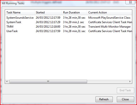

I have been trying to resolve a problem with my computer going in to sleep mode but unfortunately, all the steps that I have followed (from page 1 of this thread) have not resolved my problem. The issue is that I can get my laptop to go into sleep mode by pressing either the power button once, closing the lid or selecting 'sleep' from the menus but it will not go in to sleep mode automatically. It will activate the screen saver and then turn of the screen OK but just refuses to go to sleep mode. Any further help as to how I may resolve this would be most appreciated.
Many Thanks
Andy.
Hello Andy,
It sounds like you may have something is preventing your computer from being idle and allowing it to enter sleep mode after the amount if idle time you set it to do so. You might check to see if it may be caused by something that is running in the background. In addition, disconnect any external device (ex: USB, printer, etc...) from the computer to see if it may be a cause as well.
Hello Andy,
Hi Shawn,
Many Thanks for your reply. I don't have any external devices connected to my computer right now so don't think it is that causing the problem. I did just check my scheduled tasks again and noticed that there are 4 tasks which appear to be running permanently. Could this be what is causing the problem? I've attached a screenshot of what they are so not sure what they are and if they should be running permanently.
Regards,
Andy.
Could be. You could test by stopping them to see if your computer will go to sleep after the idle wait time you set. Do you have all programs closed as well?
No Luck I'm afraid. I stopped the running tasks/closed all programs but still sleep would not work. Interestingly, when I re-boot my computer and do not touch anything, just leave it in the User Selection screen, it will go into sleep automatically as expected. However, as soon as it is brought out of sleep with the press of a key/movement on touchpad, it will no longer go back into sleep mode. Could this give a clue as to what it may be?
Regards
Andy.
Thanks for the link. Unfortunately, this did not fix the problem. However, I think I may have identified the issue. I have a device entitled 'NVIDIA nForce 10/100/100 Mbps Ethernet' which when disabled, causes the sleep operation to work correctly. The issue now becomes how to fix this. The driver version is 73.3.5.0 so I guess the first thing is to check it is up to date. The 'Allow computer to turn of the device' option is checked so that is not the issue. Must be a problem with the driver.
Andy,
Check using STEP 6 in the tutorial to uncheck Allow this device to wake the computer to see if you may be able to leave the network adapter enabled and still have the computer sleep afterwards. If you do not use the network adapter, then it's not going to hurt anything to just leave it disabled though.
Does the network adapter have any errors listed for it in the "General" tab under "Device status" in Device Manager?
The Allow this device to wake the computer option is unchecked. In the advanced settings, the only apparent option related to Wake is a WakeOnLAN from PowerOff option which is set to enabled. There are no errors in the general tab.
Disable that option, and also check in the "Advanced" tab for either option below to set them the same below if there to see if that may help.
