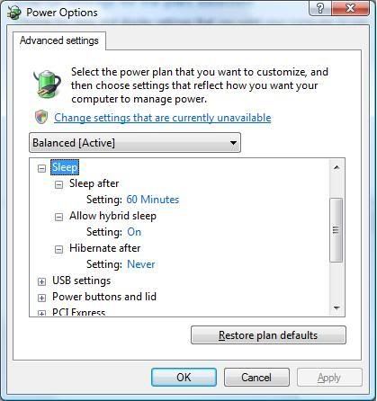

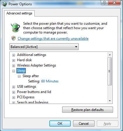

Check Advanced Power Plan Settings
NOTE: Power settings control the computer’s ability to go into and come out of sleep/standby mode.
2. Click on the Power Options icon.​
3. Click on the Change plan settings link under your power plan. (See screenshot below)​
4. Click on Change advanced power settings. (See screenshot below)​
5. Click on Change settings that are currently unavailable. (See screenshots below step 10)​
NOTE: This will allow any Power Options that are grayed out to now work and not be grayed out.​
6. Recommended Settings for Sleep

7. Recommended Settings for Hybrid Sleep
NOTE: Hybrid sleep saves your open documents and programs to memory and to the hard drive, and then puts the computer into a low-power state. After the Hibernate after time you set, it will then put the computer into hibernation.
WARNING: Use the same Recommended Settings for Sleep in step 6 above, except for these changes:​

9. Click on OK to apply​
10. Just exit out the other windows.​
11. Test sleep mode. If it is still not working correctly, then continue to the next step.​

What sleep options are missing from the Control Panel Power Options window?
Double check the Power Management options for devices (Ex: Network) to make sure that they are set to not wake up the computer in Step 5. Also, check to make sure that the Wake On ... options in the BIOS are not selected.
First, thanks for welcoming me :)
Now, I'll get on to the problem.
I'll try just having my computer sleep with the default audio and video, and I'll post back. I will also, after that, load the Windows Update drivers and see if it works (as some other suggestions I was given had said to do). I have made sure nothing is set to wake the computer from sleep (in BIOS and device manager).
Screenshot of my control panel's sleep applet
-Orion
EDIT: P.S. I have SP1 installed (Vista 64 Ultimate SP1 disk from Microsoft Action Pack).

I just tried to uninstall the drivers. Windows wouldn't sleep with the default video driver :p. So I tried the default Windows Update drivers and found the same problems. So, that didn't help much. I tried to enable the hibernation thingy, so that might help.
Screenshot of power applet now:
