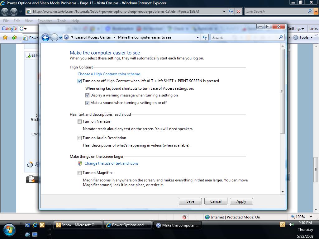

attached is a screenshot...I don't see that option.

LOL, GB1099
If I happened to be in the neighborhood I would, but I'm a good hour or more north of you and my bu** is dragging today. ;)
Don't be :o , but just scroll down a bit and you will see it as the last item to uncheck. :p
I guess I didn't bother to scroll down....it was late and I didn't see it...LOL.
Anyway it already was unchecked.....but good try anyway.
