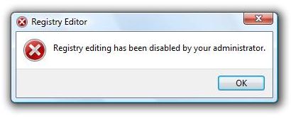

hi,
somehow, I erased several applications... I no longer have: task manager, run (in "start"), system configuration and power ("start" shows only "logg off");
I tried the method with download to enable task manager or power, but, error,
what should I do?
Hello Dauphine, and welcome to Vista Forums.
If you are not sure how this happened, then you might run a thorough virus and spyware scan to be safe. That error message is usually a sign on malware if you did not do it.
Method Three in this tutorial will show you how to enable the Registry Editor (regedit) again.
http://www.vistax64.com/tutorials/116415-regedit-enable-disable.html

Hi Shawn,
it works;
I enabled regedit.exe;
than I followed the steps to enable task mgr; it works, too
thank you
(please believe that this is a big achievement for a novice )
