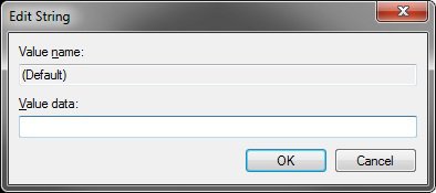

Shawn, I went into reg. to policies and systems and put in Disable taskMrg and modify to 1, as shown on your screen shot. but above that where you show (Default (value not set) mine shows a value of 1 in that spot. How do I change it to (value not set)
Hello Dan, and welcome to Vista Forums.
You can right click on (Default), click on Modify, leave/make the value to be empty like below, and click on OK. This will be the same as (value not set).
    Logitech MX Master 4
Hello Shawn,
Went back in and deleated the value,as you said, restarted and still no task Mrg. Then went back in and right clicked ,New,DWORD ,Disable,enter , Modify 1, all those things and then DisableTaskMgr and Delete then yes and then closed and restarted , and still no Task Mgr. Now when I look that place there is (Default) REG SZ no value or anything listed after SZ
