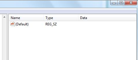

Hello Shawn,
Went back in and deleated the value,as you said, restarted and still no task Mrg. Then went back in and right clicked ,New,DWORD ,Disable,enter , Modify 1, all those things and then DisableTaskMgr and Delete then yes and then closed and restarted , and still no Task Mgr. Now when I look that place there is (Default) REG SZ no value or anything listed after SZ
Thanks, Dan
Dan,
Could you post a screenshot showing these registry entries and values?
Have you tried using METHOD TWO with the REG files instead to have this done automatically for you?

Hello, Brink
Here is a screen shot
I also tried #2 and a note pad message came up I didn't know what to do.
Please keep helping. Thanks, Dan..
Ah, I see now.
The default associations for your REG file extension are incorrectly set to Notepad. In Default Programs (Method Three at link), set the REG file extension to have it's "Current Default" program set as Registry Editor ( C:\Windows\regedit.exe).
Afterwards, try merging the REG download again. :)
