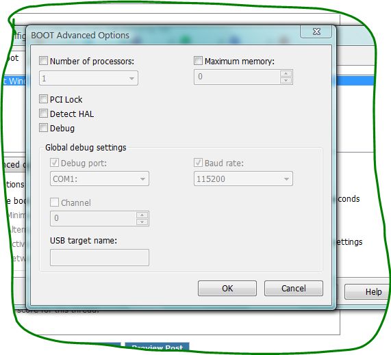

I finally solved this problem. I had ignored it for a while but decided to tackle it again yesterday. I ran Msinfo32.exe and it reported I had only 1 core and 1 logical processor. Also I downloaded a gadget (All CPU Meter) and it only showed 1 core in use.
Not knowing quite what to do next I opened the Boot screen-Advanced Options and de-selected the # of processors box(see JPG). I then did a reboot and went back to the Boot screen-Advanced Options and, lo and behold, I now had a choice of 1 or 2 processors again.
I rechecked withMsinfo32 and it reported I now have 2 cores and 2 logical processors. Also, All CPU Meter shows both cores in use.
Such a simple solution, and I now have a more responsive system.
Ed
