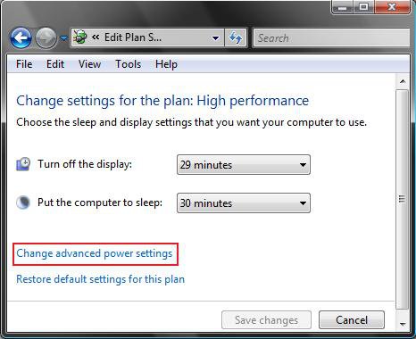

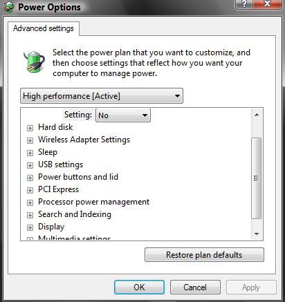

Check Advanced Power Plan Settings

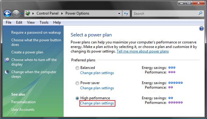

NOTE: Power settings control the computer’s ability to go into and come out of sleep/standby mode.
2. Click on the Power Options icon.​
3. Click on the Change plan settings link under your power plan. (See screenshot below)​
4. Click on Change advanced power settings. (See screenshot below)​

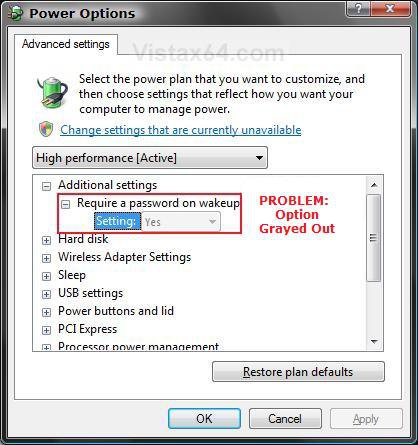

5. Click on Change settings that are currently unavailable. (See screenshots below step 10)​
NOTE: This will allow any Power Options that are grayed out to now work and not be grayed out.​
6. Recommended Settings for Sleep
NOTE: Sleep saves any open documents and programs to memory only, and then puts the computer into a low-power state.
WARNING: If you lose power to the computer, you will also lose what is in memory.​
Main Setting

9. Click on OK to apply​
10. Just exit out the other windows.​
11. Test sleep mode. If it is still not working correctly, then continue to the next step.​

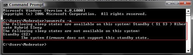

1. Open the Start Menu.​
2. In white line (Start Search) area, type cmd and press Enter.​
3. In command prompt, type powercfg -a and press Enter. (See screenshot below)​
NOTE: This will give you a report of the available sleep states for your computer and will attempt to report reasons why sleep states are unavailable. You will want to see if the ACPI S1 and/or S3 is listed.
4. Restart the computer into the BIOS settings, and go into the Power Management section in the BIOS.​
NOTE: Usually you will press the F2 or Delete key as soon as your computer starts booting to enter the BIOS.
5. Make sure ACPI mode: S3 or S1 is enabled.​
WARNING: S1 (Sleep) and S3 (Hybrid deeper sleep). If you are running an incompatible video card, some or all of these states below may be unavailable. If one of the settings causes your computer to not wake back up afterwards, then reset the CMOS on the motherboard and restart the computer, or unplug the computer for a moment and plug it back in, and reset the BIOS back to the factory default settings.
6. Make sure Wake on Ring and Wake on Lan are disabled.​
NOTE: This will help keep the computer from waking up on its own.​
7. Save the BIOS setting changes and exit to restart the computer.​
8. Test sleep mode. If this does not help, then move on to the next step.​

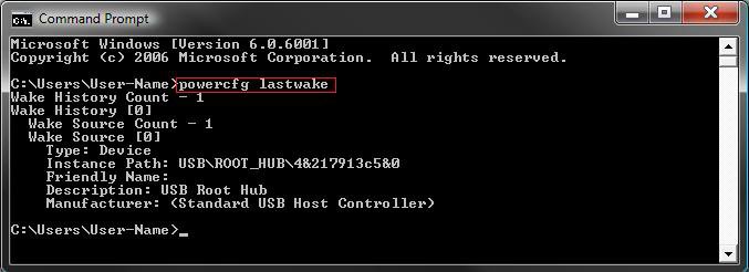

To See what had Waken Up Windows Last
NOTE: This will give you a list of items that woke up the computer last that may help narrow down what is waking up the computer.
3. In command prompt, type powercfg lastwake and press Enter. (See screenshot below)​
NOTE: Notice that I had USB\ROOT\HUB listed. For me, this would be the USB wireless mouse. Your list results will vary of course.​

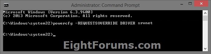

STEP 5

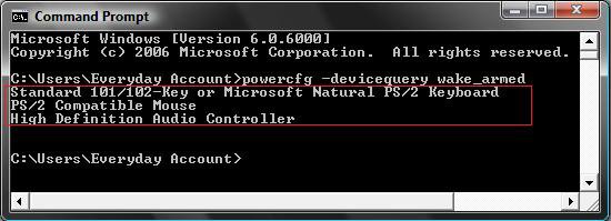

To List, Enable, or Disable Device Names Currently Configured to Wake Up the System From any Sleep State
NOTE: This will show you a list of devices that are able to wake up your computer to help you narrow down a device that may be responsible for waking up your computer. It does not mean that these devices are the ones that woke up your computer though, just that they are able to.
2. To List Devices that Can Wake Up the Computer
A) In the command prompt, copy and paste in bold: (See screenshot below)​
powercfg -devicequery wake_armed and press Enter.​
B) Go through the list of devices to see if you have one you do not want to wake up your system.​
EX: A Network Device (Modem, Ethernet, etc.) or Wireless Mouse.​
C) If you found a device that may be causing the problem, then check with the STEP SIX section below first to see if you can disable a wake up option for the device in it's Power Management settings in Device Manager to test to see if that is it before proceding.​

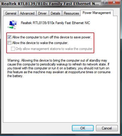

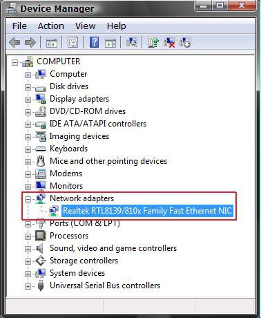

STEP 6
To Disable or Enable the "Allow this device to wake the computer" Option for a Device
  • Check your Network device. Network activity can cause the network hardware to wake the computer, especially when the network is always on (like cable and DSL connections).
  • High Definition Audio, if listed in STEP FIVE, may also rarely cause the computer to wake from sleep mode. You can disable (only option available) the device as a test in Device Manager to see before putting the computer to sleep. Just enable it again if it is not the problem.
2. Click on the Device Manager icon.​
NOTE: You need to be in a Administrator account.
4. Open the device's list that you want to change. (See screenshot below)​
EX: Network Devices
5. Right click on the device name and click on Properties.​
EX: Network Devices
6. Click on the Power Management tab. (See screenshot below)​
7. Uncheck Allow this device to wake the computer. (See screenshot above)​
NOTE: To Enable it again, just check this instead. If you need to disable the wireless mouse and keyboard, then you can wake the computer by pressing the power button on the case.
8. If listed, check Allow the computer to turn off this device to save power. (See screenshot below step 6)​
NOTE: This will turn the device off when the computer goes into sleep mode.

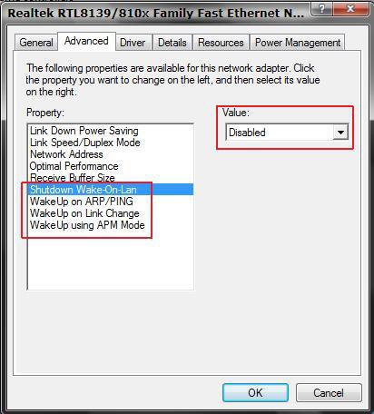

9. Click on the Advanced tab. (See screenshot below)​
NOTE: This is only for the Network device.
10. Check the boxed in red Property: items below to see if they are set to Disabled in the Value: area. (See screenshot above)​
NOTE: This area may be different for your particular network device since it is based on the driver, but it should be similar. You will be looking for any Wake on type property options listed.​
11. Click on OK to apply and close properties window. (See screenshot below step 6 or 9)​

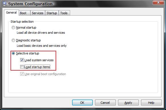

STEP 8
Check Startup Programs
  • Many software components start up automatically with Vista and run in the background. Some of these programs may not be necessary, and can interfere with the sleep/standby mode. For troubleshooting purposes, use the following steps to prevent programs from starting up with Vista to see if this is the issue.
  • If you are having these problems, you can avoid from having to do this completely if you logoff and put the computer to sleep from within the logon screen.
A) In the white line (Start Search) area, type msconfig and press Enter.​
B) Go to step 3.​
OR
2. Click on All Programs, Administrative Tools, and System Configuration.​
4. Under the General tab, dot Selective startup. (See screenshot below)​
NOTE: When done with the test, dot Normal startup, to return to the default settings before the test, and click on OK.
5. Uncheck Load startup items and click on OK and restart the computer.​
NOTE: You will get a notification that you made changes to the Startup programs in the bottom right Notification area. Just ignore it for now. It will go away when you put it back to Normal startup after you finish.
6. Test sleep mode.​
7. If unchecking (disabling) Load startup items fixed the sleep problem, then enable one startup item at a time and test to see if the problem occurs again. Continue enabling startup items, until you find the program that is causing the problem. Remove or update the problem program.​
NOTE: See Method One or Two here: How to Check and Change the Startup Programs in Vista
A) When done, change the setting back to Normal startup (step 4).​
8. If unchecking (disabling) Load startup items did not resolve the sleep problem, then set it back to Normal startup (Step 4) and go to the next step below.​

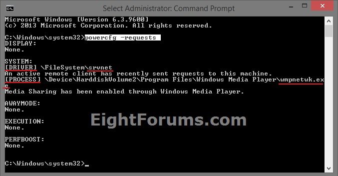

STEP 14
View and Override Power Availability Requests
By using power availability requests, applications, services, and drivers can temporarily disable power management features to accomplish user scenarios. Availability requests can prevent the display from turning off after inactivity, and prevent the computer from automatically sleeping, enable Away Mode, and shutting down.

Okay this is the issue. My pc will wake up randomly from sleep. I've narrowed it down to the nic. If I unplug the network cable from the pc it will sleep fine and not wake up until I tell it to. However, wake on lan is disabled in both the bios & nic properties. Furthermore, my pc has s1 & s3 power states. s3 is the problematic one. s1 will never wake unless told to do so by me even when the network cable is plugged in! s3 will randomly wake if the network cable is plugged in. I have the latest bios & nic drivers. My mobo is intel dg45id & built in nic is 82567lf-2. I did a live chat with intel support & they say it's not a known issue. Any guesses?
Hello Drivenbywhat, and welcome to Vista Forums.
The next time it wakes up you like this, do STEP FOUR with the lastwake command to see if it may be able to help you narrow it down to exactly what may have triggered it to wakeup.
Do you also have the latest chipset drivers installed for your motherboard?
Hope this helps for now,
Hello Brink,
I've tried many things and that is how I was able to pinpoint it to the nic being the culprit while in s3 sleep stage. Step four is one I've also tried and it doesn't give anything useful. Just a zero. It's as useful as the event viewer telling me "wake source unknown". Yes, I do have the latest chipset drivers as well. It just bugs me that it works fine in s1 but not s3. It bugs me even more that intel would make a mobo that has s1 & s3 yet its built-in nic has problems staying off with s3. After chatting online with their support for the 2nd time I got an email address that I can write them about this problem and hopefully make it a known issue so they can fix it.

I have disabled all devices, but my keyboard, so
>POWERCFG -DEVICEQUERY wake_armed
Microsoft USB Digital Media Pro Keyboard (IntelliType Pro)
I don't think that the keyboard is the problem. I tried with keyb and mouse and lan disconnected from my computer without success.
