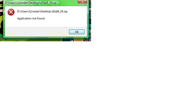

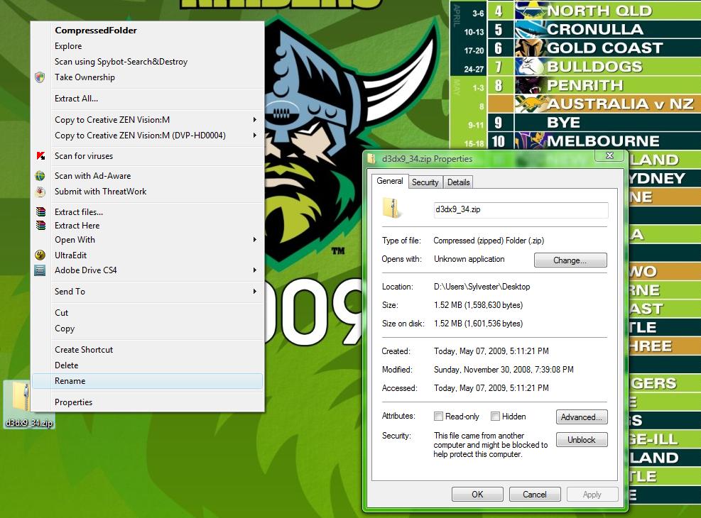

Thanks for the quick reply. I checked the .reg and it had regedit as the default program. I have attached a picture of my problem.

Rocky,
It looks like you have the program WinRAR installed from seeing the icons next to "Extract Files" and "Extract Here" in the context menu. Uninstalling this program would most likely restore your default ZIP associations afterwards.

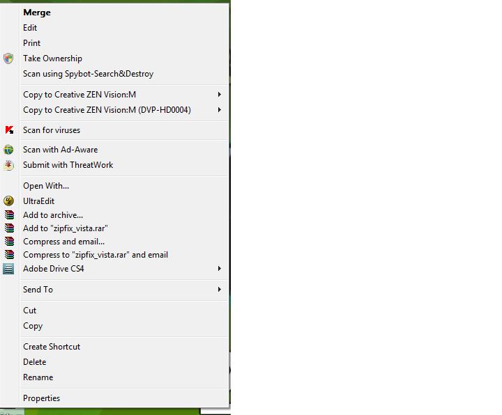

When you right click on the .reg file, what do you see?
I uninstalled winrar but it made no difference. I have attached the error I get when I click on a zip file. If I right click and click "explore" it works how I want it to.
Umm, I don't see how your still getting the "application not found" error when merging the .reg file when the .reg file extension is set for Registry Editor (C:\Windows\regedit.exe) in Default Programs. :confused:
